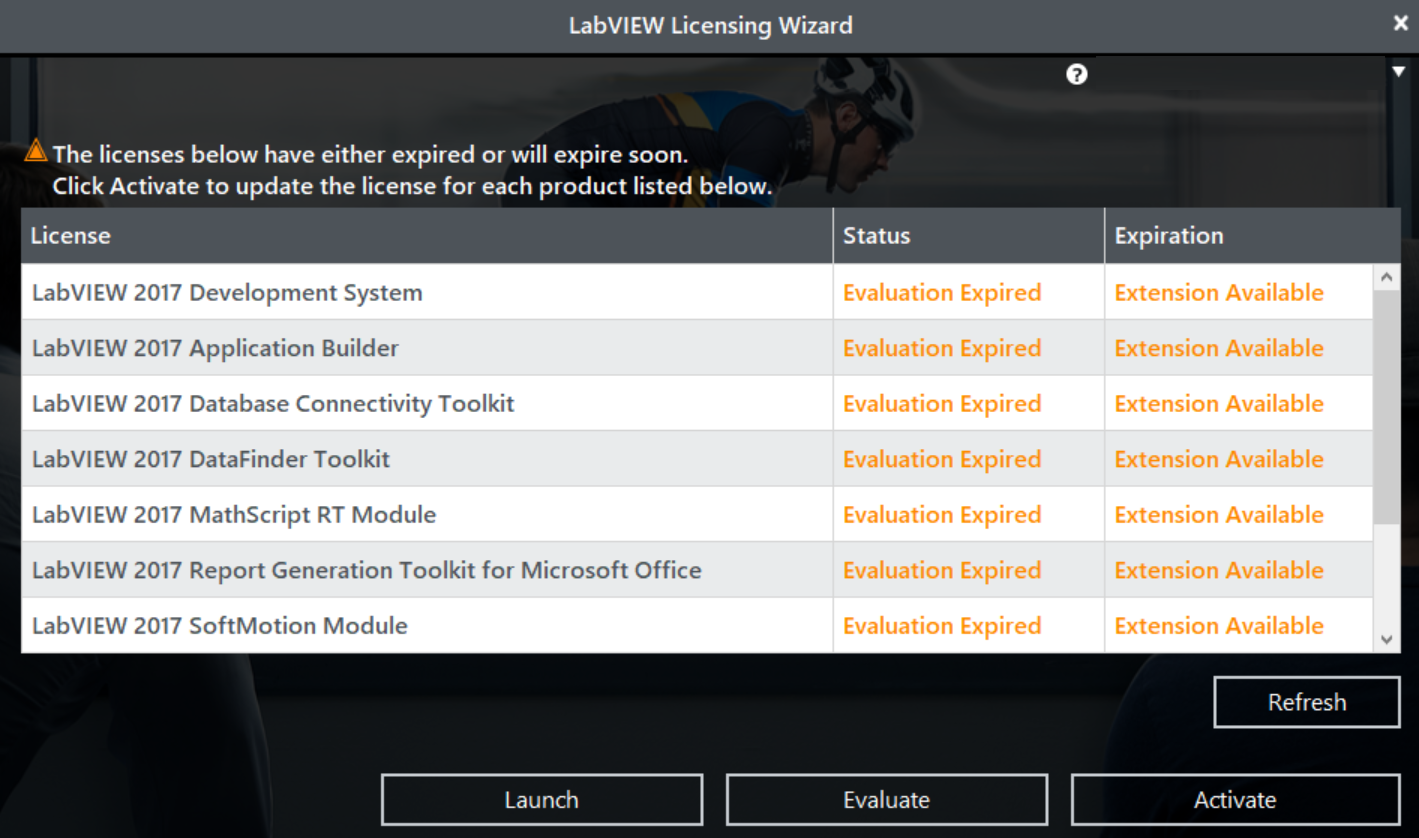

  • I made a Disconnected License in Volume License Manager (VLM) for my offline computer and installed it successfully. However, when I try to launch NI software, it shows up in Evaluation mode in NI License Manager.
  • When I try opening NI software that is included in my Disconnected License file, I receive a warning saying that the Evaluation Licenses are about to expire or that are already expired.
This issue occurs because the NI License Manager is pulling the Evaluation Licenses before pulling the licenses from the Disconnected License file.

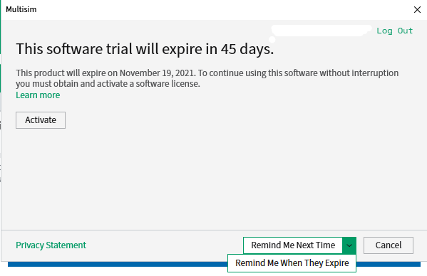

  • Upgrade License Manager to 4.7 or the latest version available and let the evaluation expire.
    Download NI License Manager 4.7 or newer. After updating NI License Manager and launching software, the following activation window will appear. Click Remind Me When They Expire to prevent future notifications of expired Evaluation Licenses. In doing so, the Evaluation License will naturally expire and the Disconnected License will take over.
