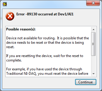

When I attempt to acquire data with my NI Multifunction I/O (MIO) module, I  receive the following error message:
Error -89130: Device is not available for routing. It is possible that the device needs to be reset or that the device is being reset.
If you encounter this error, please try the following steps:
  1. Review this article if you are communicating with a DAQ device on a real-time (RT) target.
  2. Reset the device in Measurement & Automation Explorer (MAX).
    1. Open MAX and find your device under Devices and Interfaces.
    2. Right-click your device and select Reset Device.
    3. If you encounter Error -88705, check the status of NI Device Loader. You can also reset the device programmatically using the DAQmx Reset Device VI.
