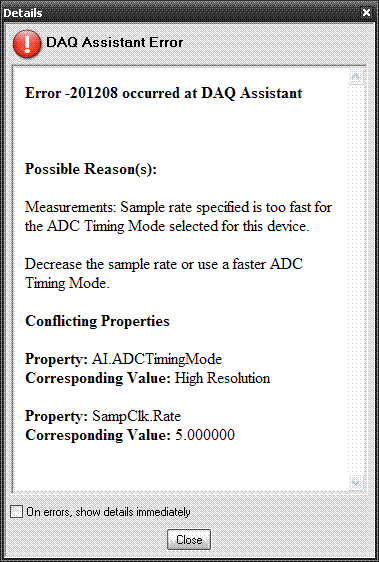

  • For certain sample rate settings, I receive DAQmx Error -201208: Sample rate specified is too fast for the ADC Timing Mode selected for this device. What does this error mean and how can I control the timing mode of the module when using NI-DAQmx?

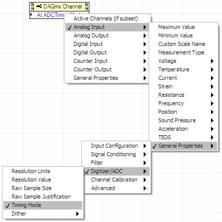

Each option listed in the table (e.g. High Speed) is actually a user-programmable setting that can be defined in code. This property is called the ADC Timing Mode. In this property, you can choose from High Speed, Best 60 Hz Rejection, Best 50 Hz Rejection, and High Resolution modes.
Error -201208 is generated when the module is requested to perform at a sampling rate that it is not currently configured to support. For example, requesting a 5 Hz sample rate when the device is configured in high resolution mode and the max sample rate is 2 Hz.

LabVIEW and LabVIEW NXG
In LabVIEW, the mode property can be programmed using the DAQmx Channel Property Node (located on the Functions palette), as shown below.
