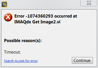

  • I am working with a Basler sca1390 camera and have connected it to a laptop using a Startech Firewire ExpressCard. When I run an example Vision VI as an executable, the deployment computer reports the following error:
Error -1074360293 occurred at IMAQdx Get Image2.vi
Possible reason(s):
Timeout.
The error doesn't specify the exact reason of why the issue appears, in order to cover all the grounds please follow the recommendations below:
  • Increase the timeout value on the input terminal of the IMAQdx Get Image2 VI.
  • Increase the timeout value on the NI Measurement and Automation Explorer (NI-MAX) configuration for the camera.
  • Try doing a Snap or a Grab in NI-MAX and verify whether the behavior is repeated there.
  • Signal Integrity Issue: If you have multiple cables or long USB 3.0 cables, make sure you only use one cable, and you are within 5m length. USB3 standard is highly affected by cable quality and signal quality. If you do not have a high-quality cable, you could be losing the signal due to poor connection quality. Try one, high quality cable that is under 5m long.
