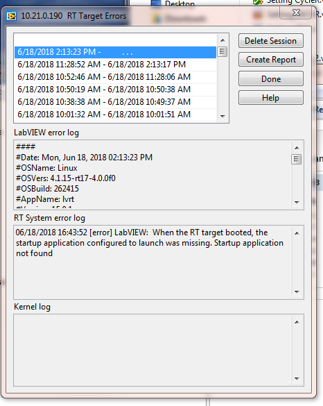

      • My Real-Time executable appears to be crashing, and when I check the Error Logs I see the following:
      There are a number of problems that can result in an executable not running on start-up. Follow the troubleshooting steps below for the settings that are applicable for your system.

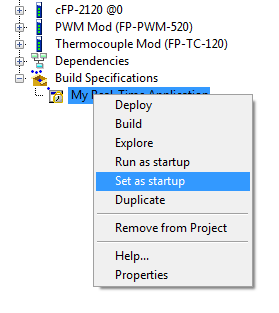

      • Ensure that the Real-Time Application is set as the start-up application.
        1. Right-click on the application within the LabVIEW project, and select Set as startup as shown in the image below. Once an executable has been set to run at start-up, you will notice that the specified build is enclosed in a green box.
        2. If you choose Run as startup , LabVIEW will inquire as to whether you want to restart the device. When the controller is rebooted, your application should load on start up.

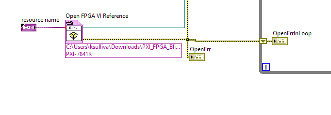

        • If your device works when Debugging Tools are Enabled, see if there is an error code by remotely debugging the executable using LabVIEW. To verify sources of errors, ensure that you are wiring errors from points of interest into loops, otherwise, they could be cleared. Please review the image below for more information:
      • Ensure that the Real-Time Operating System is able to start all required services before the start-up application attempts to execute by including a Wait function of 30-60 seconds in the application’s start-up sequence, example in the figure below. This is a good step when using R Series cards with older PXI controllers, as some of their processes take time to start up.
      Note: This behavior can also occur in large applications that require multiple background processes to load before execution can begin. In these situations, it is possible that the RT OS cannot start all required services before the application attempts to execute (generally the first part is the Open FPGA VI Reference), causing a system to hang or crash. This is commonly seen when utilizing a RIO in hybrid mode and a call is made to the FPGA when before the scan interface has finished loading. A solution in this situation is to include a Wait function in the application's start-up sequence, which should allow the controller to finish loading without overloading the CPU.

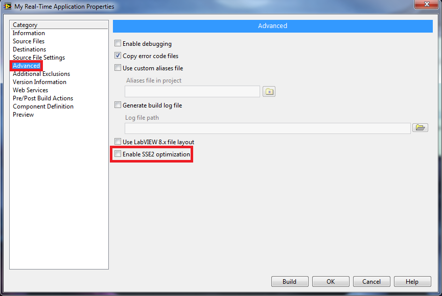

      • If you are using SSE2 Optimization in your compilation, ensure that your target supports SSE2 instructions. If not supported by your target, disable this option in your build specification:
        1. Right-click on your build specification and select Properties.
        2. Navigate to the Advanced category, and uncheck Enable SSE2 Optimization as shown below.
      Note: As of LabVIEW 2017, SSE2 optimization can no longer be disabled. You can no longer deploy real-time executables to targets that do not support SSE2 in LabVIEW 2017 and later.
