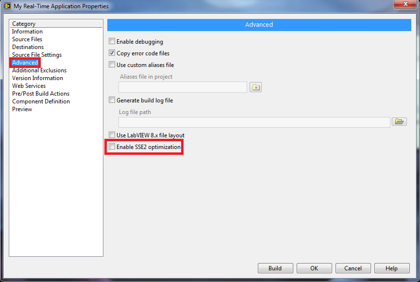

  • If you are using SSE2 Optimization in your compilation, ensure that your target supports SSE2 instructions.
    • If your target does not support SSE2 Optimization, disable this option in the Application Properties.
    • Navigate to the Advanced category, and uncheck Enable SSE2 Optimization as seen in Figure 5.
    • Note: As of LabVIEW 2017, SSE2 optimization can no longer be disabled. You can no longer deploy RT EXEs to targets that do not support SSE2 in LabVIEW 2017 and later.
Figure 6: Disable SSE2 Optimization in Application Properties
