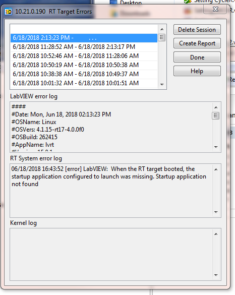

  • My Real-Time executable appears to be crashing, and when I check the Error Logs I see the following:
There are a number of problems that can result in an executable not running on start-up. Follow the troubleshooting steps below for the settings that are applicable for your system.

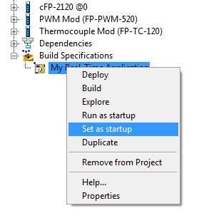

  • Ensure that the Real-Time Application is set as the start-up application.
    1. Right-click on the application within the LabVIEW project, and select Set as startup as shown in the image below. Once an executable has been set to run at start-up, you will notice that the specified build is enclosed in a green box.
    2. If you choose Run as startup , LabVIEW will inquire as to whether you want to restart the device. When the controller is rebooted, your application should load on start up.

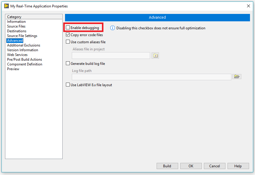

    • If it is not possible to remove property nodes that reference front panel objects and you cannot enable embedded UI, you can enable debugging to include the front panel in the build:
      1. Right-click on your Build Specification and select Properties.
      2. Navigate to the Advanced tab.
      3. Check Enable debugging as shown in the image below. Note: This will increase system resource utilization on your real-time controller due to the additional processing required to include and run the application's front panel.

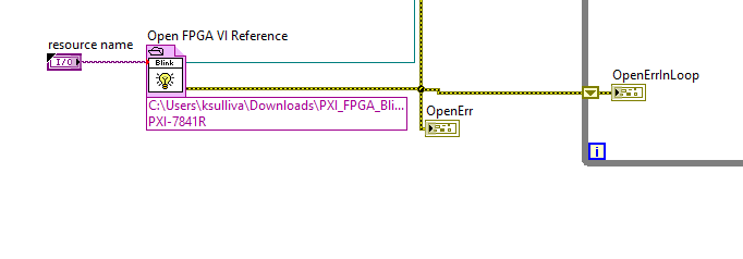

    • If your device works when Debugging Tools are Enabled, see if there is an error code by remotely debugging the executable using LabVIEW. To verify sources of errors, ensure that you are wiring errors from points of interest into loops, otherwise, they could be cleared. Please review the image below for more information:

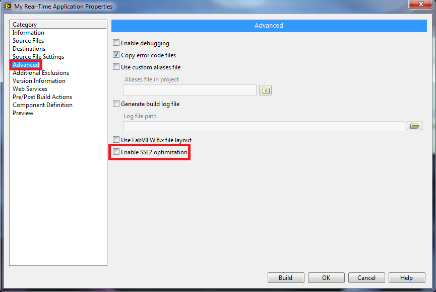

  • If you are using SSE2 Optimization in your compilation, ensure that your target supports SSE2 instructions. If not supported by your target, disable this option in your build specification:
    1. Right-click on your build specification and select Properties.
    2. Navigate to the Advanced category, and uncheck Enable SSE2 Optimization as shown below.
Note: As of LabVIEW 2017, SSE2 optimization can no longer be disabled. You can no longer deploy real-time executables to targets that do not support SSE2 in LabVIEW 2017 and later.
