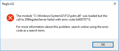

With Windows 10 version 1607 and forward,
pdm.dll
can no longer be registered manually, but must be automatically registered by a Microsoft product. If trying to register manually,
RegSvr32
will throw error
0x80070715
![](/servlet/rtaImage?eid=ka03q000001EMcT&feoid=00N0Z00000HEWRt&refid=0EM0Z000000WClU)
