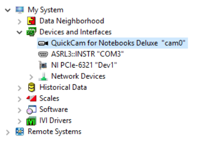

Once the correct driver is installed, the camera should show up in NI MAX under Devices and Interfaces.
