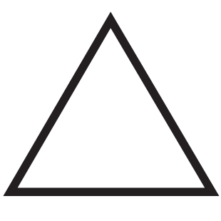

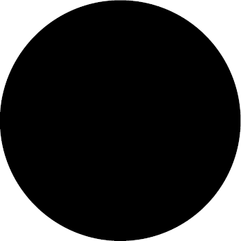

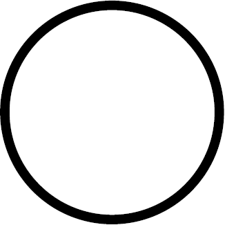

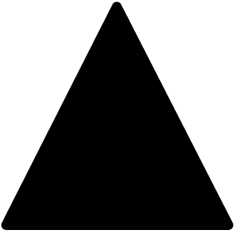

The PXI-1 and PXI-5 Hardware Specification define a list of glyphs associated with the different PXI(e) slot and module types.
A table with all PXI(e) slot glyphs and their meanings is shown below:
Slot TypeDescription
PXI System Controller Slot
PXIe System Controller Slot
PXI Peripheral Slot
PXIe Peripheral Slot
PXIe Hybrid Peripheral Slot
(Supports PXI Hybrid and PXIe Modules)
PXI System Timing Slot
PXI Star Trigger Slot
PXIe System Timing Slot
(Also works as PXIe Peripheral Slot)
For more information about the different PXI(e) slot and module types, refer to the Related Links section.
Note that these glyphs can be found both on the PXI(e) chassis' and module's front plate.
Note that some slot types can have more than one use, like the PXIe System Timing Slot, which also works as a PXIe Peripheral Slot.
