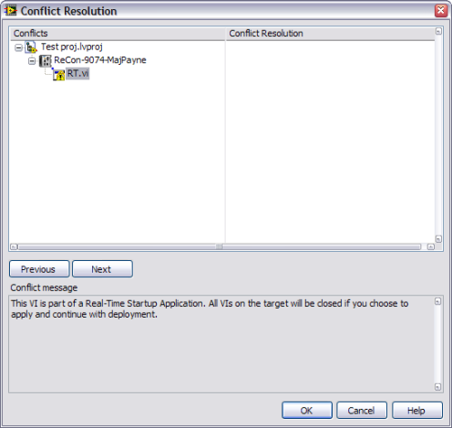

  • I made a real-time executable (RTEXE) and set it as the startup executable.  However, I can't connect to it using my host PC.  I am using Network Shared Variables hosted on the real-time target.
  • When I try and connect to my real-time target, I get a Conflict Resolution window and my application stops running (Alternative: My application only runs when I hit deploy. Once deployed, if I disconnect and reconnect, it doesn't run)

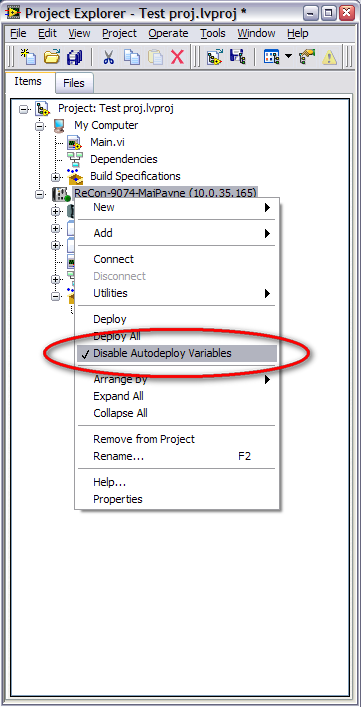

  • Option 1: Right-click on the  controller and select Disable Autodeploy Variable

The reason that this is happening is that the Host VI is trying to redeploy the Shared Variable Library to the target before it connects to it. In order for this deployment to be successful, it has to abort execution of the RTexe. Once it has connected, since the RTexe was aborted, it won't run. This is why redeploying the application works.
Since the library only needs to be deployed once, we can connect to the RTexe without redeploying the library by using any of the methods noted above. The reason this works is as follows:
  • In Option 1, by disabling auto-deploy, the Host VI will just connect to the Shared Variable Library that already exists on the target. If changes to the library need to be made, then it will have to be manually deployed once again.
