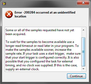

  • When I run my LabVIEW program using a DAQmx Read VI I get an error that says:
Error -200284 occurred at DAQmx Read (Polymorphic).vi
Possible reason(s):
Measurements: Some or all of the samples requested have not yet been acquired
The error was returned because the timeout occurred before all samples requested were received. The following are different ways to help you avoid this error:
Adjust the timeout value:
There is a timeout input for the DAQmx Read VI. The timeout specifies the amount of time in seconds to wait for samples to become available. Please refer to the DAQmx Help: DAQmx Read (VI) for more context.
If your sampling rate is low and/or your samples to read is high the time specified for the timeout may elapse, returning an error. To correct this, increase the timeout to accommodate the rate and the samples to read. In general, the timeout value should be larger than the number of samples to read divided by the sample rate.
Increase the sample rate:
The sample rate should be larger than the samples to read divided by the timeout. In a DAQ Assistant Express VI, you can configure this on the Configuration tab in Timing Settings >> Rate (Hz). For more context refer to the DAQmx Help: DAQmx Timing (VI) .
Decrease the number of samples to read:
The number of samples to read should be less than the Sample Rate multiplied by the timeout. In a DAQ Assistant Express VI, you can configure this on the Configuration tab in Timing Settings >> Samples to Read.
