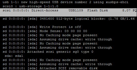

Detecting Connected USB Devices:
It is possible to verify that a USB device has been detected by the NI Linux RTOS when it is initially plugged into a USB port on the target.  Once logged in to the Real-Time target, connect a USB device and issue the command dmesg to the console, then press enter.  Information similar to that shown in Figure 1 will be displayed.  You can search the information for text related to the device you have plugged into the target.  This is a reliable method for determining if the NI Linux RTOS can identify your device.  This does not guarantee that the device is usable with the target.
Figure 1. Typical dmseg Information About a USB Storage Drive
