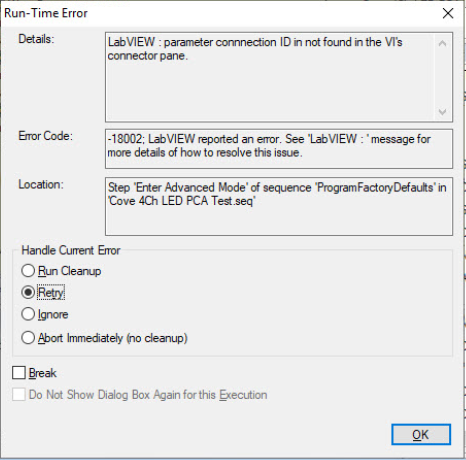

I am getting a -18001 or -18002 error in TestStand. What can I do to resolve this?
The -18002 Run-Time error message says the following:
Run-Time Error
Details: LabVIEW: parameter <specific parameter name> not found in the VI's connector pane.
Error Code: -18002; LabVIEW reported an error. See 'LabVIEW :' message for more details of how to resolve this issue.
An example of the Run-Time error message is shown below:
There are several sources for this error code as explained below:

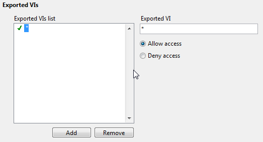

Server Access Denied
  • If you also get Error: LabVIEW VI Server Access Denied when opening LabVIEW VI this problem may be due to the VIs exported by LabVIEW, to change this option:
  1. Open either a new or existing VI in LabVIEW.
  2. Select Tools >> Options from the LabVIEW menu bar.
  3. Select VI Server: Exported VIs from the list box at the top of the dialog. This displays a list of VIs that are exported by LabVIEW.
  4. Enter a * in the exported VIs field so that you expose all VIs. Then select VI Server: Browser Access (or VI Server: User Access if using LabVIEW 8.x or later) from the list box and make sure that you have given permission to * (everyone), specific domains or IP addresses.
