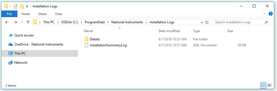

Note: In Windows 7, 8, 8.1, and 10,  C:\ProgramData is a hidden folder. Enter the file path directly into the Windows Explorer address bar as shown in the image below.
