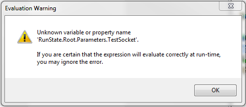

TestStand 2010 SP1 and Previous:
The specific variable to which the report file path is saved is dependent on the specific process model you are using. With the file path, we can utilise the Split function to find the filename.
Sequential Model:
RunState.Root.Locals.ReportFilePath
Batch and Parallel Models:
RunState.Root.Parameters.TestSocket.ReportFilePath
For TestStand 2012 and later the default process models uses a plugin architecture for reporting, hence why the report file path is easiest to access through the GetReportFilePath callback. This callback is executed after the client's MainSequence completes. To access the report file path elsewhere in the sequence, this value could be stored in a file global variable.
For TestStand 2010 and prior, the variables have no data stored within them until run-time, checking for errors or evaluating an expression that uses these variables will result in an Unknown variable or property name error message.
