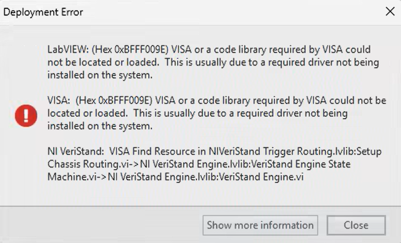

  • When attempting to use NI-VISA to communicate with hardware in LabVIEW or NI MAX, I am getting error message: Error -1073807202: (Hex Code: 0xBFFF009E) A code library required by VISA could not be located.
  • When deploying a Veristand project in a Windows device, I obtain the following pop up error:
How can I troubleshoot this?
