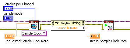

Programmatic Access in LabVIEW:
You can read the actual sample rate used through DAQmx Timing Property Nodes by selecting Sample Clock ยป Rate. Below is an example of this in LabVIEW:
Figure 1:  Using a DAQmx Timing Property Node to Read Coerced Sample Rate
