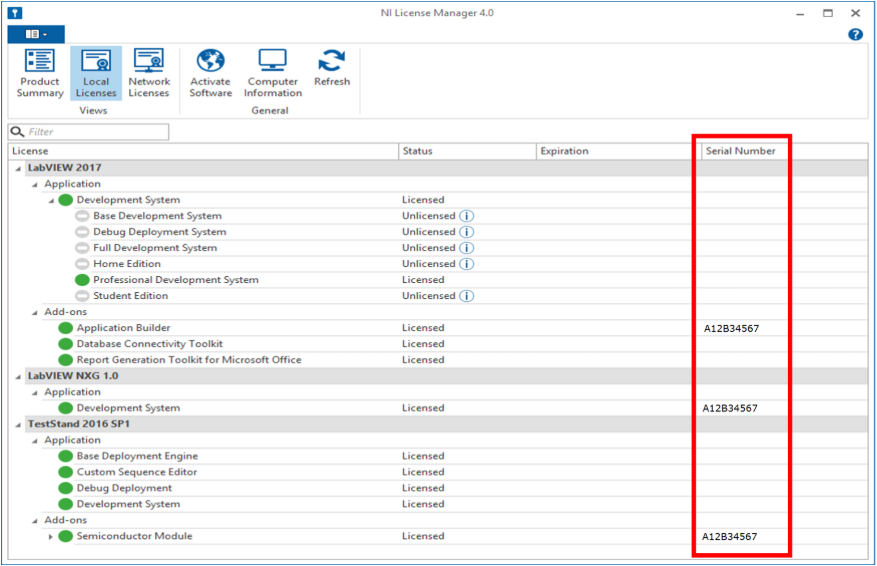

The updated serial number will appear in NI License Manager, which can be opened by navigating to Start » Programs » National Instruments » NI License Manager.
NI License Manager 4.0 and higher:
NI License Manager 3.7 and lower:
