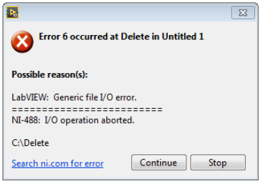

  • I am receiving Error 6 in LabVIEW:
Error 6 occurred at Delete in Untitled 1
Possible reasons(s):
LabVIEW: Generic File I/O error.

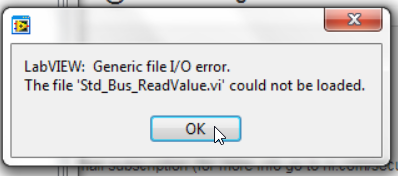

  • When running an executable made with the LabVIEW Application builder, I get a Generic File I/O error. What can I do to fix this?
  • I am trying to run a LabVIEW installer on a network folder, and I am getting the following error:
LabVIEW: Generic file I/O error
The file <file name> could not be loaded
Error 6, or Generic File I/O Error, is a common error that is generated when a file operation in LabVIEW or the user's code fails to execute.
Try the following steps to troubleshoot this error:

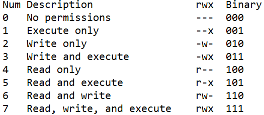

  • On Linux Real-Time targets (e.g. cRIO and sbRIO) ensure that the lvuser account has access permission to a drive, folder, or file. This is especially important if you add external storage with a USB memory stick, or  NI 9803. Use the chmod command to change permissions.
    • You can run chmod 777 to give all permissions to all users; for Real-Time targets it is suggested to use chmod 755 for security reasons. The below image gives more context for what the chmod permissions achieve.
    • First Number - For the user, Second Number - For the group, Third Number - For others.
