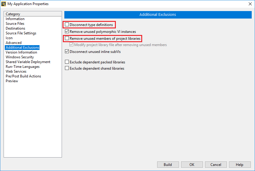

  • Uncheck the following settings in Additional Exclusions as seen in the screenshot below: Disconnect type definitions and Remove unused members of project libraries.

When building an application, the first step that LabVIEW does is to make a copy of the code as a source distribution to a new directory, along with changing settings for the purpose of compiling into a single EXE file. Error 1502 occurs when something in that process goes wrong. This is caused by weak links which can occur from several things such as Diagram Disable Structures, bad dependencies, etc...
