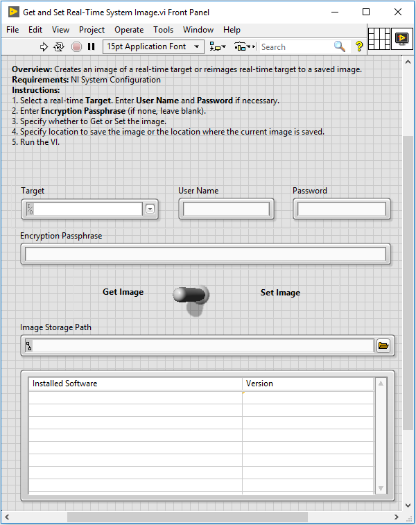

Use the LabVIEW example Get and Set Real-Time System Image.vi  found in LabVIEW under Help >> Find Examples. This VI may provide more reliable results than the RAD utility and contains detailed error messages which aid in troubleshooting.
If you receive an error that states "The specified path does not contain a valid image", Then follow the instructions in the article: The Specified Path Does Not Contain a Valid Image
