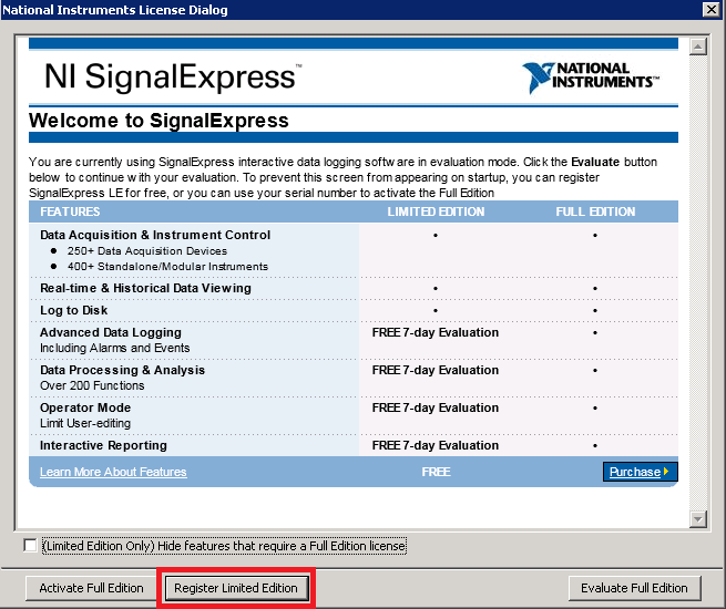

On opening SignalExpress within the first 30 days of installation, you will see the following License Dialog Box:
![](/servlet/rtaImage?eid=ka03q000000tBiE&feoid=00N0Z00000HEWRt&refid=0EM0Z000000WCpg)
1. Select
Register Limited Edition to register/activate SignalExpress LE.
2. Continue through the remaining pages with the default settings.
3. You should now have access to SignalExpress.
