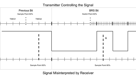

BRS denotes the point in the CAN frame where the bit rate is switched from the nominal rate (used for the Arbitration ID and header) to the data rate. A transmitter will send the BRS as a recessive bit until the sample point, at which it immediately switches the data rate.
It is imperative that the sample point of all nodes match since the data bit rate is usually much higher than the nominal rate. If the nominal rate sample point does not match with another node, many data bits can be transmitted early or misinterpreted during the overlap between the transmitter's sample point and that of the receivers.
For example: A transmitter and receiver are configured with a data bit rate that is 4X the nominal bit rate. The transmitter sends a frame with a nominal rate sample point of 60% to a receiver with a sample point of 80%. At the sample point, the transmitter will switch to the faster bit rate while the receiver is still waiting to sample the signal. The transmitter then continues with the rest of the frame and the receiver may read an indeterminate value or an incorrect value (A). The sample points for the remainder of the data will continue to be offset and errors will ensue.
