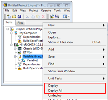

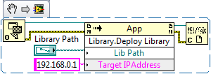

我想以编程方式从实时目标部署共享变量。我可以从主机上执行此操作,但是每次我尝试以编程方式从目标上进行部署时,都会得到
Error 1043. LabVIEW: The property or method is not supported in this version of LabVIEW.
