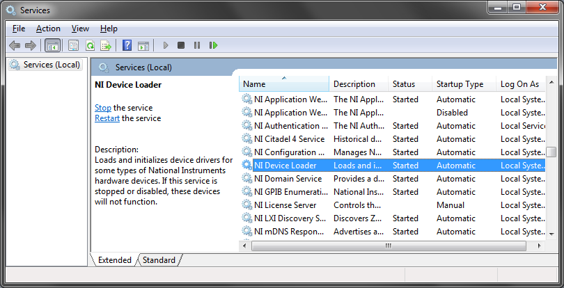

If the NI Device Loader service is not running, Windows is unable to load the information from the firmware. To see what services are currently running on your computer, select
Start»Control Panel»Administration Tools»Services.
If NI Device Loader is not started, right-click
NI Device Loader and select
Start. The Startup type for the service should be set to Automatic. If it is not listed as Automatic, right-click
Properties. Set the Startup type as
Automatic.
