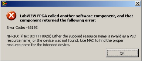

I get the following error when I try to run my FPGA code, or open it via a reference:
"Error Code: -63192
NI-RIO: (Hex 0xFFFF0928) Either the supplied resource name is invalid as a RIO resource name, or the device was not found. Use MAX to find the proper resource name for the intended device."
Why could this be occurring and what troubleshooting steps could I do to resolve this?
