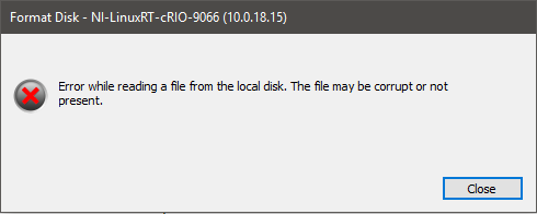

  • When I try to format my Linux-based Real-Time target in Measurement & Automation Explorer (MAX), I get the following error message:
Error while reading a file from the local disk. The file may be corrupt or not present​.

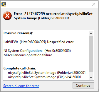

  • When I try to apply an image to my controller using the System Configuration API or when I use the RAD Utility, it returns the following error message:
Error -2147467259 occurred at nisyscfg.lvlib:Set System Image (Folder).vi:2060001

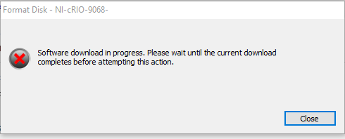

  • Upon attempting to update the firmware version of one of my NI Linux Real-Time Controllers it never completed the update (after waiting approximately 15 minutes) which led to this error:
Software download in progress. Please wait until the current download completes before attempting this action.
