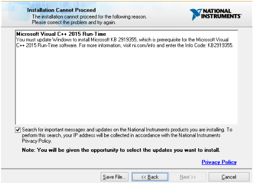

問題敘述
安裝NI軟體時,出現錯誤訊息 "
You must update Windows to install Microsoft KB 2919355, which is a prerequisite for the Microsoft Visual C++ 2015 Run-Time software. For more information, visit ni.com/info and enter the Info Code: KB 2919355."

要能夠成功安裝Microsoft Visual C ++ 2015 Run-Time,您需要根據作業系統安裝以下相依軟體:
操作系統
VC2015運行時
Windows 8.1
KB 2919355
Windows Server 2012 R2
KB 2919355
Windows 7的
Service Pack 1
Windows Server 2008 R2
Service Pack 1
Windows Vista
Service Pack 2
Windows Server 2008
Service Pack 2
安裝完成後,即可在Windows中安裝
Universal C Runtime
的
更新
