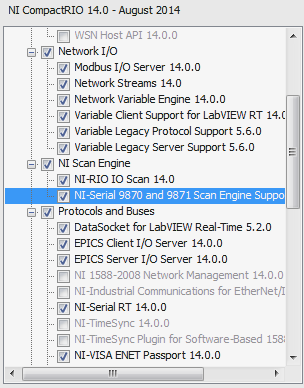

  3. Right-click the Software tab, and select Add/Remove Software.
  4. Choose Custom Software Installation and click Next.
  5. In the Custom software installation window, select the NI-Serial 9870 and 9871 Scan Engine Support.
  1. Click Next to start the installation.
