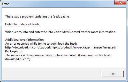

NI 패키지 관리자(NIPM)에서 제품을 설치, 업데이트 또는 업그레이드할 때 다음과 같은 통신 에러가 발생합니다.
There was a problem updating the feeds cache.
Failed to update all fields.
Visit ni.com/info and enter the Info Code NIPMCommError for more information.
Additional error information:
An error occurred while trying to download the feed:
http://download.ni.com/support/nipkg/products/ni-package-manager/released/Packages.gz
The network is down, unreachable, or has been reset. (Could not resolve host: download.ni.com)
