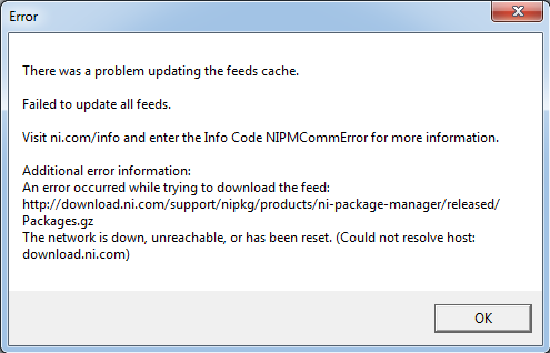

I receive the following communication error when installing, updating or upgrading a product from within NI Package Manager (NIPM).
There was a problem updating the feeds cache.
Failed to update all fields.
Visit ni.com/info and enter the Info Code NIPMCommError for more information.
Additional error information:
An error occurred while trying to download the feed:
http://download.ni.com/support/nipkg/products/ni-package-manager/released/Packages.gz
The network is down, unreachable, or has been reset. (Could not resolve host: download.ni.com)
