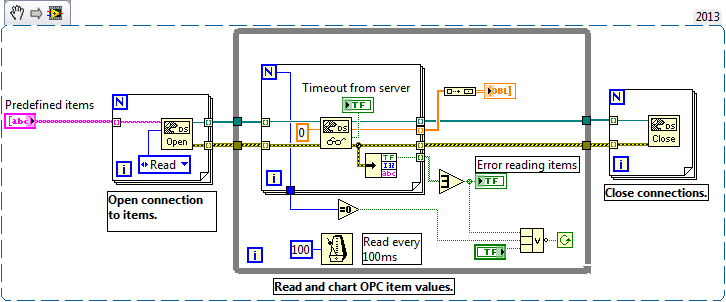

I have multiple OPC items that I would like to read with DataSocket. Are new DataSocket connections required for each OPC item?
Yes, a new DataSocket connection is required for each individual OPC Item. You may look at the screenshot below for an example.
  • DataSocket only support one OPC item per connection.
  • Connecting in ReadAutoUpdate mode may increase performance when reading multiple items on the same OPC server, as the server will send all notifications of new data in one packet.
  • OPC data can also be read using Shared Variables.
  • For communication with large number of connections, the LabVIEW Datalogging & Supervisory Control (DSC) Module or NI OPC Servers may be a better fit.
  • You can also find shipping examples as a good starting point. Go to LabVIEW » Help » Find examples... and search for Monitor OPC Items with Datasocket.vi
