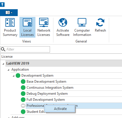

  • If you have a license for LabVIEW Professional Development system, activate it NI License Manager by opening Local Licenses >>  right-click LabVIEW Professional Development System >> select Activate
