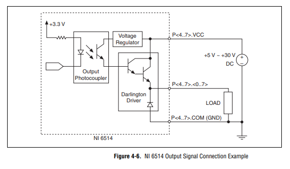

  • I am using either the +5 Volt line or digital output lines on my NI 651x to perform a digital output task. I'm not seeing any response when measuring the terminals though. Why is this happening?
  • Do I need to provide an external supply to out the digital outputs on my PXI-651x card?
Yes, according to page 3-3 of the 651x manual , you need to provide a +5V - +30V power supply to the card in order to use the 5 volt lines, or perform digital outputs.
"The output lines on the NI 6515 consist of photocouplers and Darlington
arrays. To connect to these signals, connect a 5 V to 30 V power supply to
COM, connect GND to ground, and cross a load between digital output
and COM."
Schematic drawings on how to provide this external power supply can be found below (sourced from page 4-6 of user manual).
Note: The schematic diagrams for each 651x card differs slightly. Refer to the User Manual to see the exact connections for your device.
The 651x family uses 24V logic. This means a low signal will output 0V-4V, while the high signal will output 11V - 30V. If you want to change the low signal to output 0V exactly, you can use a Pull-down resistor
