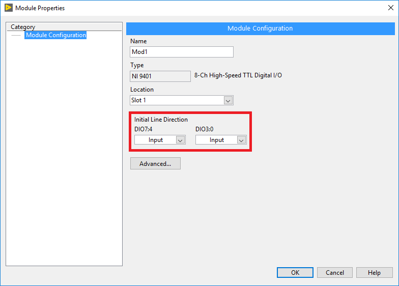

Using the NI-9401 in a cRIO Chassis
When using the NI 9401 in a CompactRIO chassis, the way to configure the module for input or output is as follows:
- The initial input/output configurations can be configured from the module properties dialog box. To get to module properties, right right-clicke module in the Project Explorer and click Properties.
Note: the CompactRIOs with DAQmx will have the Real-Time Scan Resources and Real-Time Resources. The Properties options mentioned above will only be available if the module is placed under the Real-Time Scan Resources. If you need to place it under the Real-Time Resources, then you need to follow the steps provided for DAQ Chassis.
- You can also change the direction of the lines programmatically using I/O method nodes. You can create a method by going in the Functions Palette and selecting Programming » FPGA I/O » I/O Method. Once you place the method, right-click it and go to Select Item » Mod(x). Now click on Method and select Select Line Direction.
