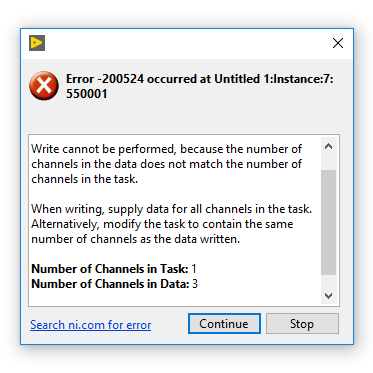

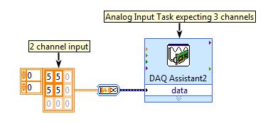

If instead, we write more or fewer channels, the error will show the difference in the expected and received number of channels.

![](/servlet/rtaImage?eid=ka00Z000001E0Ee&feoid=00N0Z00000HEWRM&refid=0EM0Z000000RqYa)
Figure 2: LabVIEW example of analog data mismatch
![](/servlet/rtaImage?eid=ka00Z000001E0Ee&feoid=00N0Z00000HEWRM&refid=0EM0Z000000RqYf)
Figure 3: Resulting error from both cases displays the channel difference
