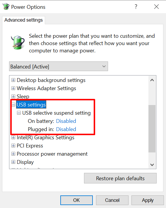

This may occur due to a Windows setting called USB selective suspend. By default, this setting is enabled. When enabled, it cuts power to idle USB devices in order to conserve power.

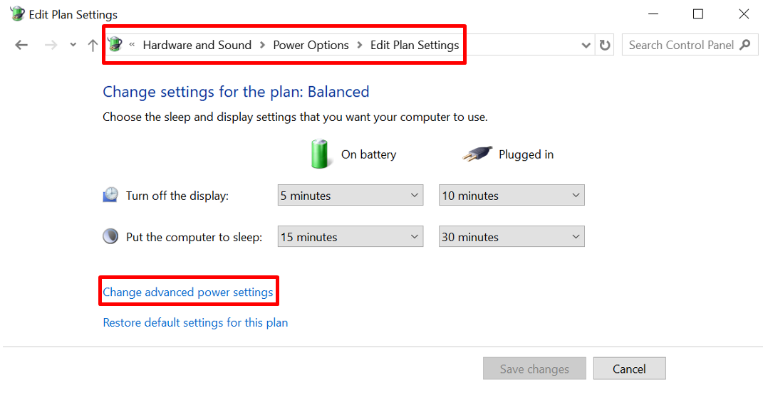

This setting can be disabled through Performance Settings as follows:
  1. Go to Power Options via: All Control Panel Items » Power Options » Edit Plan Settings
  2. Select Change advanced power settings.
  3. Expand the USB Settings tab and disable USB selective suspend settings
