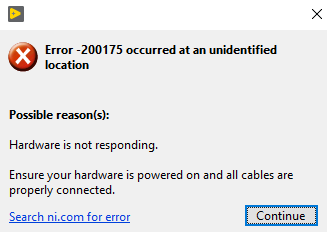

I am receiving one of the following error codes when I am trying to configure my NI system:
  • Error -200175: Hardware is not responding. Ensure your hardware is powered on and all cables are properly connected.
Figure 1: Error -200175 occured at an unidentified location

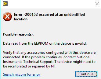

  • Error -200152: Data read from the EEPROM on the device is invalid.
Figure 2: Error -200152 occured at an unidentified loaction
These errors can be caused by issues with the device's EEPROM (electrically erasable programmable read-only memory). They may be encountered in either Measurement & Automation Explorer (MAX) or while running code that includes a task with the device in question.
