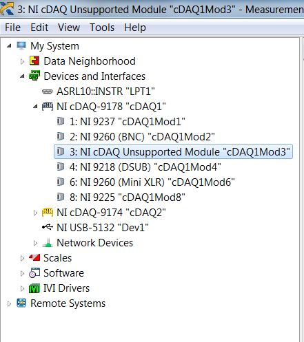

First, you need to identify if your module is the screw terminal or BNC Variant:
Note: The NI 9230 is shown in the images below, however the connector options apply to the NI 9232 also.
 NI 9230 Screw Terminal
 NI 9230 BNC
NI released the NI 9230 and NI 9232 and their variants in different iterations, and thus they require
different minimum versions of NI-DAQmx.
- The NI 9230 and NI 9232 BNC connector variants were released in 2016 and require a minimum version of DAQmx 15.5.
- The NI 9230 Screw Terminal require a minimum version of DAQmx 14.5.
- The NI 9232 Screw Terminal Connector Variant requires a minimum version of DAQmx 9.4.
You can download the latest, and previous versions of NI-DAQmx
here .
Note: Also make sure to double check the chassis that you are using, the NI 9172 does not support the 9230 or the 9232 in most versions of DAQmx. Please double check the Readme for the version of DAQmx that you are using to make sure that the chassis supports your module.
