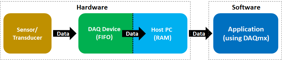

I am performing basic data acquisition using the DAQmx Timing function. How does the sample clock relate to how fast my data is read?
There are two aspects to reading data: how quickly the real world signal is digitized ("how fast?") and how much data is retrieved by software at a time from the hardware FIFO ("how much?"). These hardware-software configurations are codependent on each other.
On the hardware side, the DAQmx Timing function determines the rate of data flow from the device/sensor to the hardware FIFO on the data acquisition board. On the software side, the DAQmx Read function determines the transfer of data from the PC buffer into the software. See figure below:
Part 1: From Device/Sensor to Hardware FIFO on the DAQ Board

The Rate input of the DAQmx Timing function determines how fast the samples are acquired and put on the hardware FIFO. The value specifying the rate is dependent on the timebase specified in the source input of the DAQmx Timing function. The rate specified must be a division of the source. For example, the default source on the X Series cards is the onboard clock (100 MHz). For more information on achievable acquisition rates, refer to the following:
Part 2: From Hardware FIFO to PC Buffer and Programming Environment
How Much?
The Number of Samples Per Channel input of the DAQmx Read function determines how many samples are pulled from the PC buffer to the programming environment. The selected data transfer mechanism (bulleted below) determines how the samples are actually brought from the hardware FIFO to the PC buffer. Refer to Data Transfer Mechanisms - NI-DAQmx Help for more information.

When using the Programmed I/O method, the DAQmx Read function takes samples directly from the hardware FIFO itself. When using all other transfer mechanisms, which are hardware timed, it is recommended that the number of samples be 1/10th the rate specified on the DAQmx Timing function. For example, if the rate input on the DAQmx Timing function is 1000 (Hz), then the number of samples per channel on the DAQmx Read function should be no more than 100. This is to ensure there are not PC buffer overwrite or underwrite errors.
How Fast?
When performing Programmed I/O, the rate at which the samples are read from the hardware FIFO on the DAQ board to the programming environment is dependent on how often the Read function is called. Since the DAQmx Read function is often in a while loop, the loop rate will determine how often the DAQmx Read function is executed. The speed of the software will also be dependent on the speed of the processor and the number of processes occurring at a time.
When using the other data transfer mechanisms, the speed at which the samples are brought into the PC buffer from the hardware FIFO are independent of the execution speed of the program. For this reason, it is often desirable to use non-programmed I/O mechanisms, which enforces the use of the PC buffer, so that multiple samples can be preserved in time for the DAQmx Read function to read.

When determining how fast your data will be acquired, keep in mind that both steps in the acquisition must agree. The rate at which the data is transferred from the hardware FIFO to the PC buffer must not be too fast or too slow compared to the rate at which the data is being loaded into the hardware FIFO itself. If it is too fast or too slow, a PC buffer error will be thrown. Refer to Understanding and Avoiding NI-DAQmx Overwrite and Overflow Errors  for more information about buffer errors.
