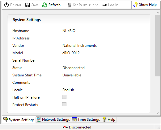

I have a device that connects to my host computer over the network or via USB. One of the following is occurring:
  • I am attempting to configure the device in Measurement & Automation Explorer (MAX). The device does not show up under Remote Systems.
  • My CompactRIO (cRIO), sbRIO, myRIO, roboRIO Controller, or Industrial Controller (IC) is not detected in NI MAX.
  • I can see my RIO device in MAX, but it says Status: Disconnected and has a little red circle next to it under remote systems.
  • In my LabVIEW™ Real-Time project, I am getting the following error: Failed to connect to real-time target.
  • I can only discover my cRIO device in NI MAX when I specify it's IP address. It does not appear under Remote Systems automatically.
  • I have a PXI chassis with an Embedded Controller that is connected to my host computer via an Ethernet cable. The chassis and modules show in in NI MAX under Remote Systems but they are listed as Disconnected.
To resolve this issue, work through the troubleshooting steps below:
  • Check that the controller's power supply is working as expected.
    • In a cRIO, for example, the POWER LED should be solid green.
  • Reboot the device.
    1. Disconnect the device from power and the computer.
    2. Restart the computer, then connect the device's power cable.
    3. Connect the device to the PC directly via a USB cable (if applicable).
    4. The device can be moved to its final network location (i.e. connection via an Ethernet switch) after its Network Settings are successfully configured.
  • Ensure that the required software versions are installed on the host PC. Use the latest software versions available if possible.
  • If the device is running a Real-Time Operating System or is an expansion chassis, it will appear under Remote Systems in NI MAX. If the device uses Windows, it will not be detected as a remote system by NI MAX.
  • Work through the Troubleshooting Utility in NI MAX.
    1. In NI MAX, right-click on Remote Systems and select Troubleshoot Remote System Discovery.
    2. See the section titled Automated Remote System Discovery Troubleshooting under Additional Information for further instructions.
    • Note: NI MAX 15.0 introduces a troubleshooting utility to assist with device discovery issues. This utility automates some of the troubleshooting process and generates a set of additional procedures tailored to specific devices and configurations.
  • Refresh the available systems in NI MAX.
    1. Delete the device from Remote Systems in NI MAX and click on the Refresh button on the top toolbar or press the F5 key.
    2. Then, wait for the system to show up again under Remote Systems.
  • This issue could result from a non-working cable. Try plugging in the device with a new Ethernet or USB cable.
  • Try removing any adapters. For instance, Ethernet to USB adapters
  • If the device is connected via a USB cable, check the status of the USBLAN adapter in Device Manager.
    1. Open Device Manager, and expand Network Interfaces.
    2. If the USBLAN adapter has an exclamation point on it, update the driver. Right-click the USBLAN adapter and select Update Driver
  • Put the Real-Time controller in Safe Mode following the instructions listed in the User's Manual of your device. If the target is successfully recognized, format it and reinstall the software.
  • Make sure no Firewall rules are blocking the connection to your system. Check the Configuring Software and Hardware Firewalls to Support NI Products article for additional information.
If the device is still undetectable after following these steps, continue troubleshooting using the steps in Setting Up Your CompactRIO System
