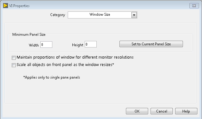

LabVIEW has several options that can be configured so that your Front Panel objects automatically adjust to new window sizes and screen resolution.
Option 1:
  • Inside LabVIEW click File»VI Properties»Categories Drop-down»Window Size
  • Click Set to Current Panel Size or make sure that the configured minimum panel size is correct.
  • Deselect both check-boxes Maintain proportions of window for different monitor resolutions and Scale all objects on front panel as the window resizes
  • Re-save the VI and try moving it to a different computer

The Maintain proportions of window for different monitor resolutions option resizes the VI so it takes up approximately the same amount of screen space when opened on a computer with a different monitor resolution.
The Scale all objects on front panel as the window resizes option automatically resizes all front panel objects with respect to and in proportion to the size of the front panel window. Text does not resize because the font sizes are fixed.
The use of the Maintain proportions of window for different monitor resolutions also applies to dual monitors having different resolutions.  By selecting Maintain proportions of window for different monitor resolutions this will maintain the proportional front panel size with respect to monitor resolution, however the physical size of the front panel will change.
For instance you have two monitors, the monitor on the left has a higher resolution than the monitor on the right.  You open a VI and select File»VI Properties»Categories Drop-down»Window Size then select Maintain proportions of window for different monitor resolutions.  If you now move the front panel from left to right you will notice that once the front panel enters the right monitor the physical size will increase, but the proportions remain the same.  This is a perfect example of how to use the property of Maintain proportions of window for different monitor resolutions.
