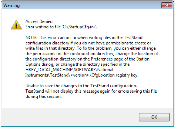

I modified the TestStand Configuration Directory from the following option:
Configure >> Station Options >> Preferences >> Configuration Directory
and now TestStand Sequence Editor won't open anymore.
I obtain the following error:
Access Denied
Error writing to file '...\StartupCfg.ini'.​
I can also get one of the following errors:
Error writing to file '...\GeneralEngine.cfg'.
Unable to save the changes to the TestStand Configuration.
The TestStand Engine cannot be initialized.
Unable to open file '...\GeneralEngine.cfg'.
Creating an instance of the COM component with CLSID... failed due to the following error: 80004005 Unspecified error (Exception from HRESULT: 0x80004005 (E_FAIL)).
How can I fix this and launch TestStand correctly?
This is usually caused by a permissions error associated with the configuration directory you selected.
You can follow three different methods to try to solve the problem.

This method involves modifying the Registry Key mentioned in the error screenshot above.
You need to follow these steps:
  1. Go to Start>>Run... and enter regedit.exe into the command line.
  2. Navigate to: HKEY_LOCAL_MACHINE\SOFTWARE\National Instruments\TestStand\<version>
  3. Double-click the CfgLocation registry key, and change the file path in the Value data box of the Edit String window.
  4. Select OK and close out of the Registry Editor.
You should now be able to open up TestStand normally.
