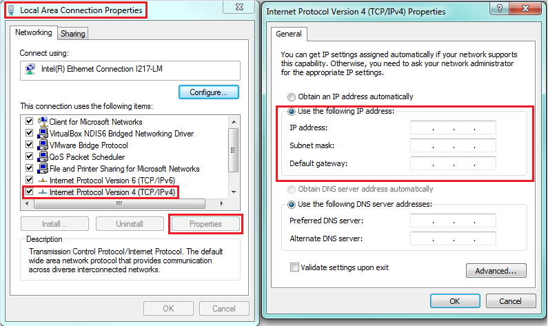

  2. In options "a" and "c", you were instructed to modify the Ethernet port settings of the host PC. To achieve this, you need to follow these steps.
    • Navigate to Control Panel»Network and Internet»Network and Sharing Center» Change Adapter Settings. Right-click the Ethernet adapter that is connected to your RT target and select Properties» Internet Protocol Version 4 (TCP/IPv4).
    • Complete the information below so the host PC can be in the same subnet as the RT target. For example, if the RT has the IP address 10.10.100.10 and the subnet mask 255.255.255.0, then you can configure the host PC with IP address 10.10.100.11 and the subnet mask 255.255.255.0. Ensure that the gateway address (if specified) is valid and belongs to a device on the same local subnet. An incorrect gateway can also trigger the Inconsistent IP Settings message.

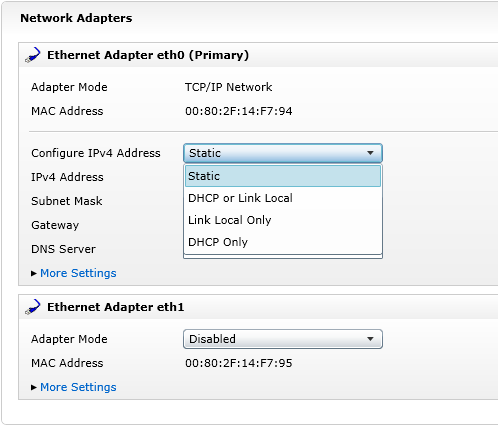

  1. In option "b", you were instructed to modify the Ethernet port settings of the RT target. To achieve this, you need to follow these steps.
    • Navigate to the Network Settings tab of the RT target on NI MAX.
    • Complete the information below so the RT target can be in the same subnet as the host. Save the changes after this.
