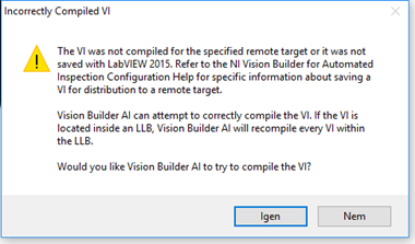

I would like to call a VI from within my Vision Builder for Automated Inspection (VBAI) inspection using the Run LabVIEW VI step. VBAI reports that the VI was not compiled for the specific remote target or saved with LabVIEW 2015 displaying the following error message:
A possible reason this may be occurring is that VBAI cannot find all of the necessary subVIs to compile your selected VI. To correct this behavior, include your top level VI in an LLB source distribution . If you want to run the inspection that includes the Run LabVIEW VI step on an embedded vision target, please refer to the section Prerequisites for embedded vision targets, otherwise please continue with the How to save a LabVIEW VI for the VBAI Run LabVIEW VI Step section.
