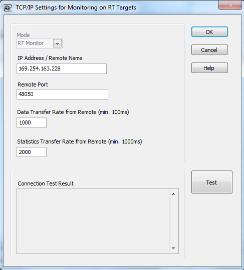

I also tried to open NI-XNET Bus Monitor from NI-MAX, by right-clicking the NI-XNET device under the remote controller, but I got the same error message.
To troubleshoot the problem, you can try to perform the following tests:
  • If you have multiple network cards, try disconnect all of them except the one connected to the Real-Time PXI controller
  • Try to connect to the Real-Time target directly with a crossover cable and set a static IP address for both the target and the computer. Make sure the IP addresses are on the same subnet
  • Try upgrade NI-XNET version to the latest one, compatible with your development environment version. Check NI-XNET Driver and LabVIEW Compatibility
  • In NI-XNET Bus Monitor, go to Settings»TCP/IP Settings: make sure that IP address of the real-time target is correct. Also, check Remote Port setting, as shown, check whether the port is already used by other applications or is blocked by Windows firewall
  • In NI-XNET Bus Monitor, go to Settings» Interface and Database Settings and set Run Mode to Subordinate
