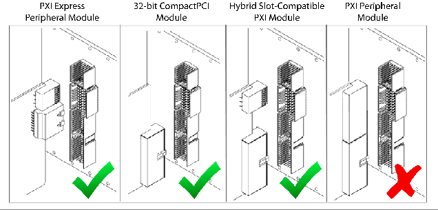

PXI Express chassis, depending on the model, will come with a combination of four types of slots: PXI Express Timing, PXI Express peripheral, PXI peripheral, and PXI Express Hybrid peripheral slots.
  • PXI Express System Timing Slots accept both PXI Express cards and PXI Express System Timing cards.
  • PXI Express slots will only accept PXI Express cards since they are missing the lower connector that Hybrid cards need.
  • PXI peripheral slots will accept PXI cards of the standard connector types- those that work in current non-express PXI chassis.
  • PXI Express Hybrid slots, due to the hybrid or combination of backplane connectors, accept PXI Express cards, 32-bit CompactPCI cards, and Hybrid Compatible PXI cards (also known as PXI Express-ready or PXIe-ready).
To determine the slot types on your chassis, refer the slot type figure meaning document. Below is an illustration of the PXI Hybrid slot type and what cards it can accept.
Figure 1: Three types of PXI backplane connectors that will fit in a PXIe Hybrid slot, as well as an illustration of the PXI standard connector that is incompatible with PXI Express Hybrid slots
Be aware that, if the chassis itself is a PXI chassis and not PXI Express, no style of PXI Express card will fit in any slot. A PXI chassis can accommodate either a PXI Peripheral Module or Hybrid Slot-Compatible PXI Module. See the pictures above for examples of these connector types.
