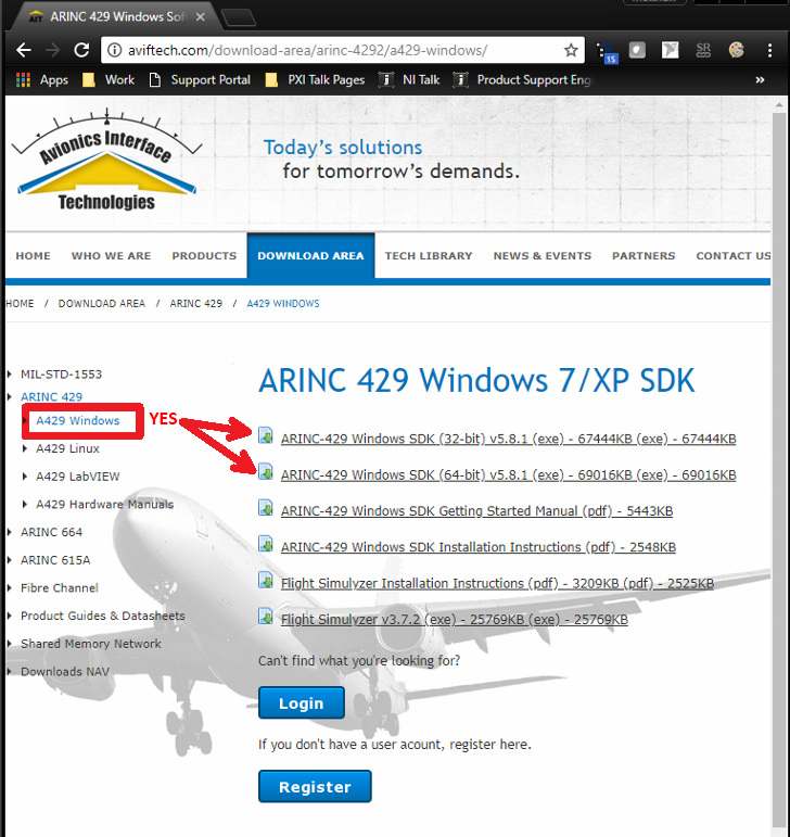

- If you can not see AIT Components you have to install both the drivers that you can see in the attached figure from AIT Website
- After the installation you must perform the following actions
- Navigate to C:\Program Files\AIT\Drivers\UAPI PCI Drivers v3.34.0
- Run DriverInstall.bat as an Admin
- Run InstallKernalPlugin.bat as an Admin
- Follow previous instructions to switch to AIT Components driver
