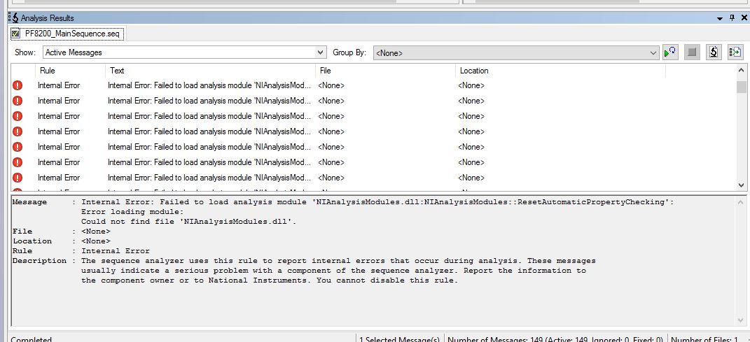

My Sequence Analyzer throws up one of the following internal errors:
Failed to Load Analysis Module. Could not find file 'NI AnalysisModules.dll'.
or
Failed to Load Analysis Module. Could not find file 'LabVIEWChecksumModule.dll'.
Please refer to the image attached:
You can solve the error by trying the following:
  • In NI TestStand, go to Configure, select Search Directories. In the new window, look for TestStand Components Directory and ensure Search Subdirectories is checked, as shown:
  • Fixing the broken VIs prevents the internal error from occurring any further.
  • If you are using NI TestStand 2016, you can run NI update service and install the f2 patch. This issue is fixed in NI TestStand 2016 f2 patch.
This is a known issue in NI TestStand 2016 environment. Refer to this link for the list of known issues by date in NI TestStand 2016.
